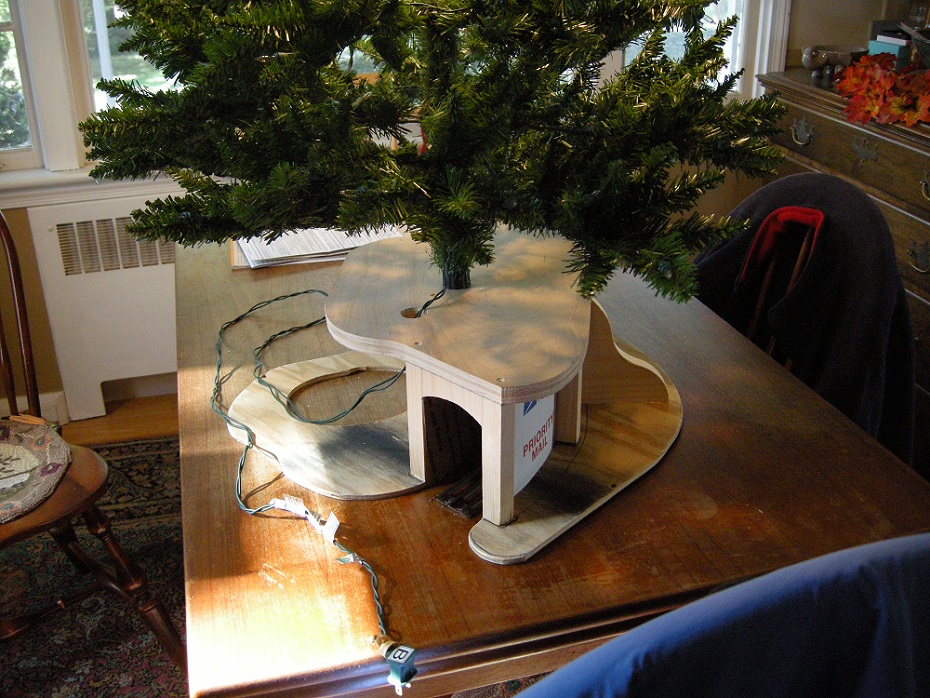

The next step was to make the tree-stand support. I cut a bunch of four-inch square pieces and glued them together in a stack. If I'd had a piece of four-by-four, I could have used that, but I didn't and there are plenty of scraps in the workshop. I then glued the stack to the base, adding a couple of woodscrews from the underside. Once that was in place, I cut a top from a scrap of 3/4-inch birch plywood I had, then screwed the top of the block tower and the tunnel portals. Next, I drilled a 1-1/8 inch hole down through the top and into the block tower, about five or six inches deep. I test fit the tree into this hole to make sure (1) it fit at the base and (2) the base provided adequate support against tipping:
- Tree test-fit
- Tunnel project d.jpg (303.43 KiB) Viewed 162192 times
Satisfied that it would be stable, I drilled a second hole down through the top to pass the power cord through, then a notch in the base for the cord to exit (that was my second design blunder...the notch should have been on the back side of the mountain, not the front). I added a contoured support to the back side between the top and the base to try to assure that the base remained flat, which it did. Now we had this:
