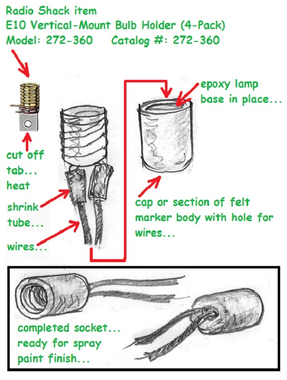

steve...
i am sure there are other ways to make a string of old style lamp sockets that will suit your needs...
but here's one you might try...see the pix for all the details...
note...paul published a piece recently about salvaging wire from strings of light...i'll post a link to it as soon as i find it...
or he may find it quicker than i will and post it...
the salvaged wire might be heavy enough to carry the voltage...but i'm not quite sure though...
i'm pretty sure that the dollar store has markers that will work for the socket bodies...
and radio shack store are everywhere...

- steve lamp socket.jpeg (135.64 KiB) Viewed 16223 times
