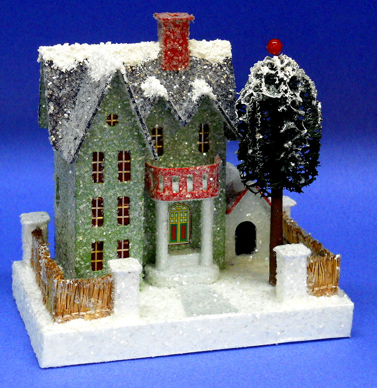

- daytime view
- may-2004-hom-LGH-version-finished 010-001.JPG (264.2 KiB) Viewed 17692 times

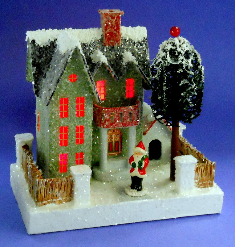

- illuminated night view
- may-2004-hom-LGH-version-finished 011-001.JPG (261.59 KiB) Viewed 17692 times

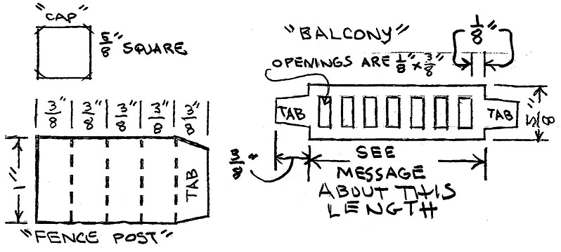

Hello Howard! I love this lovely little house (I love them all)! I am wondering if the patterns for the balcony, and fence posts are available. I can't wait to make this this new little gem. I am new to this forum and have been enjoying it since May 2015. Thank you for so generously posting patterns and advice!

Denise...hello...yes...I will post a sketch of the balcon and posts...but you may have to make minor adjustments to fit your house...but I'm sure it's something you can do...please note...it may be a day or so before I can posy...my very best regards...Howard...

denise...good morning...
here are patterns for the fence posts, caps and balcony railing...
note...the length of the balcony railing (excluding the 3/8" tabs on each side) may have to be made longer or shorter depending on the actual balcony ceiling you made...
i would suggest you do a "cut and fit test" balcony out of manila folder first...then transfer the measurements to your cardboard...then cut out the opening slots...you may also have to adjust the space between the openings or the size of the openings to get the look you want...
let me know if you need any other information...
