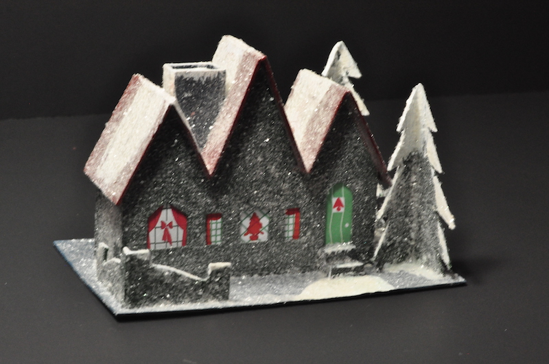

here's my little glitter house version of the three peaks dolly house...it's on a 3/4" thick base with the dolly style fence and gate...i did put in an attic window...but only went with one tree...

Thanks Howard. The silver is really nice - I like how it shows off the windows. Did you make your roof all in one piece? I made a pattern of this house and could not get the roof to fit in one piece. The thickness at the bend was too much to fit the 'V' of the house, so I had to cut my roof into 3 pieces to make it fit.

Laurie wrote:Thanks Howard. The silver is really nice - I like how it shows off the windows. Did you make your roof all in one piece? I made a pattern of this house and could not get the roof to fit in one piece. The thickness at the bend was too much to fit the 'V' of the house, so I had to cut my roof into 3 pieces to make it fit.
roofs with multiple scores and folds can be tricky...but if three pieces works for you -- that's fine...this was a one-piece roof...with some fussy fitting required...there is one thing i can suggest...score the "V" folds of the roofs on the back side of the material...not the top side like the "^"peaks...

My 3 peaks Dolly House with a view of the fence. This replica is close but I needed a larger base to place the two trees together as in the catalogue page. I chose to make this house a little smaller so it was in scale with my other houses. I like the second tree out front a bit. The original Dolly that I have of this model, and several others I have seen are quite huge compared to many of the other houses in these sets. Also interesting is the lighting on this house when I took the picture. The house, fence and trees are green and the base and chimney are blue gray. My colors seem to come out more true when I photograph them at night rather than in daylight.
