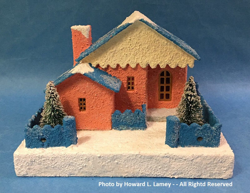

Well, here's the finished house...
- 2023 project 4 stucco country house finished.JPG (219.68 KiB) Viewed 22036 times

I really like this charming little house!!
The complimentary colors work so well. And I love the birdcage gravel texture, especially the choice to use it throughout the model. It ties everything together perfectly.
Did you mix he gravel with glue and apply it or did you mix the gravel directly with the paint?
Also, what did you use for the “snow” on the roofs and chimney?
Re: 2023 PROJECT NUMBER 4…”STUCCO FINISH COUNTRY HOUSE”…
Neal...
"Stucco" bird cage gravel finish...I paint on white glue then sprinkle on the bird cage gravel...I do one wall, part or section at a time...after drying, I go back and touch up any areas I missed...note...bird cage gravel can be sifted if you want a finer textured surface...any sand will work like builder's sand, child's sandbox sand or craft store sand...after glue and sand has dried, I prime and paint...when dry, blushes of white glue are sprinkled with extra fine clear glitter...but I don't try to cover all the stucco...
"Snow" on the roofs and chimney...I paint the area with thick white craft paint...when dry, I paint on white glue and sprinkle on extra fine clear glitter...sometimes I build up the snow area with an additional coat of white glue and extra fine clear glitter...
Hope this helps...
My very best regards...
Hope this helps...
Howard, I love this house! I wanna build it now. It looks so authentic like the vintage ones!
