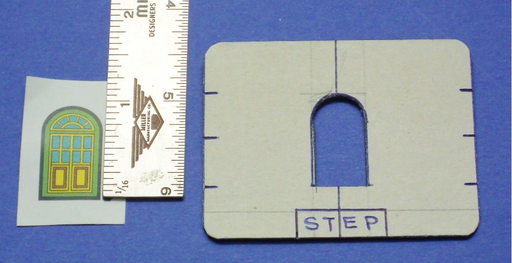

Door opening template for accurate cutting lines every time
Posts: 2434
It's a piece of cardboard with the door opening carefully measured and cut out with a hole punch, craft knife and straight edge...
Align the template it where the door should go on the house you are making...trace around the opening with a sharp pencil...then cut out the opening...
door opening template 001.JPG (210.17 KiB) Viewed 17642 times

This is wonderful. I was using thick cardboard to cut some tiny doors, and I kept tearing the upper part above the opening.
Re: Door opening template for accurate cutting lines every t
What a good idea, I will be making some of these templates for myself!
