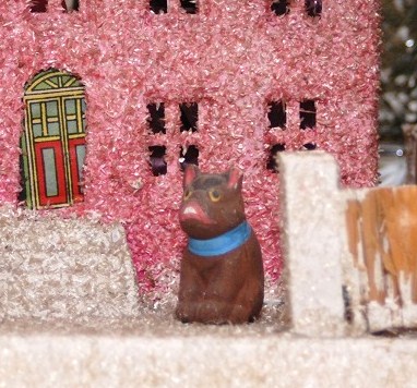

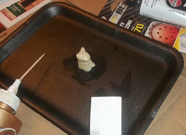

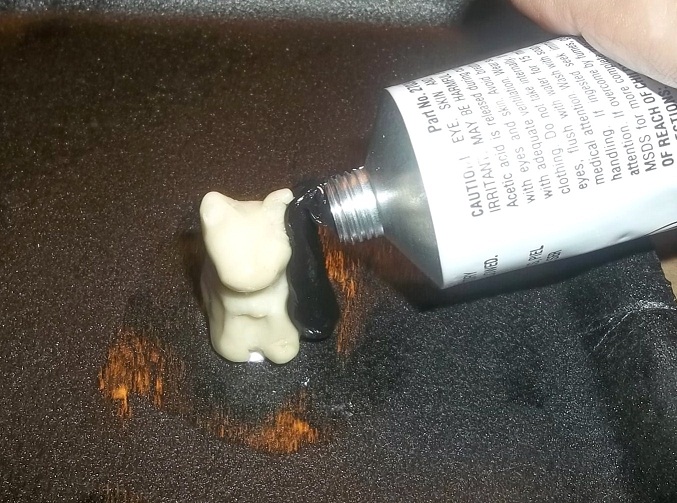

I wanted to make the dog shown on this apartment building. It appears to be an original piece but cannot say for sure but anyway I wanted this funny little bulldog. So I started by modeling it from Sculpy and baking it. I then took some black silicone (natural rubber) and this one was intended as a cement for automotive gaskets but it works well for this purpose.

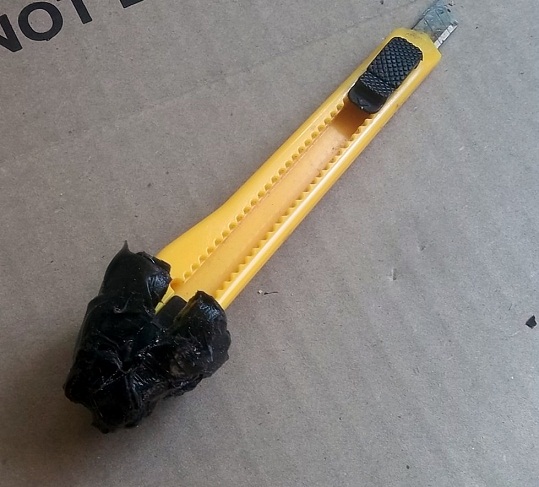

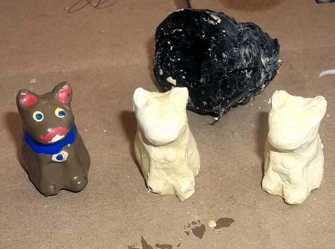

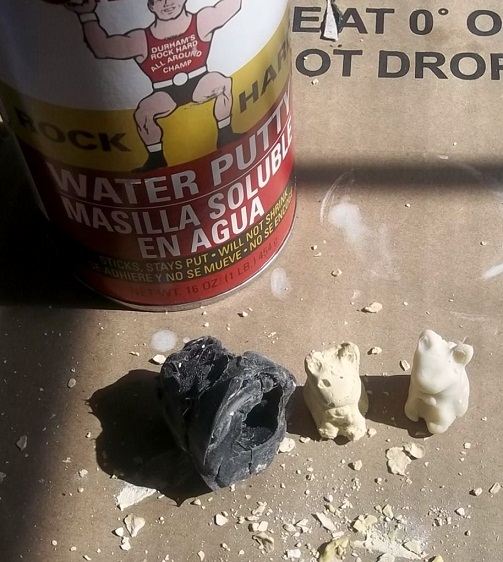

Making Molds for Putz Figures part 2
As you can see the box cutter shows the cut down the back in the mold I made for ease of extraction of the figure. The second picture shows two dogs one the model and the other from the mold. This could have had wires inserted before they it up but I chose not to do this. The last picture shows the 2 dogs from the mold and the painted hand modeled one.
