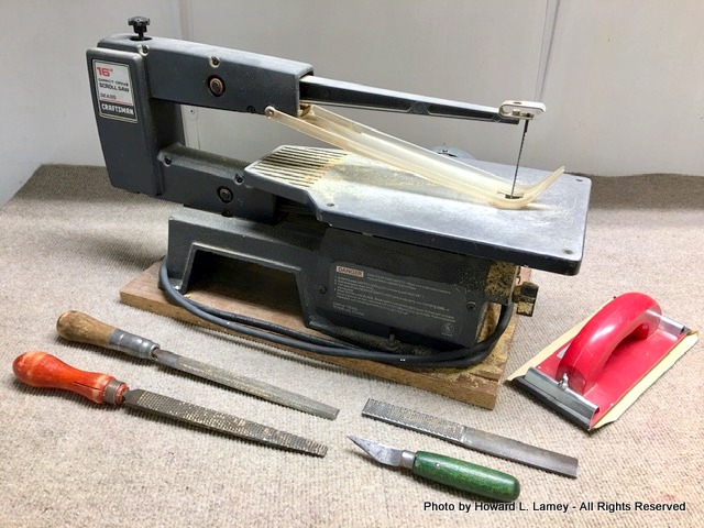

tools used to cut out, carve and shape wood body...scroll saw, rasps, bench knife and hand sander...tool not shown is a Dremel(R) rotary tool and round tip cutting burr...i'll add a picture of them to the next update...

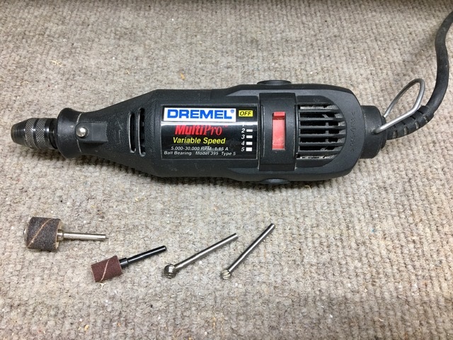

Dremel (R) tool plus sanding drums and round head cutting burs used on sheep...the burs were used for shaping the ears...
Hole saw and power drill used to cut out wheel rims...pix of wheel construction will be posted later...

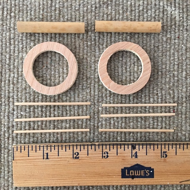

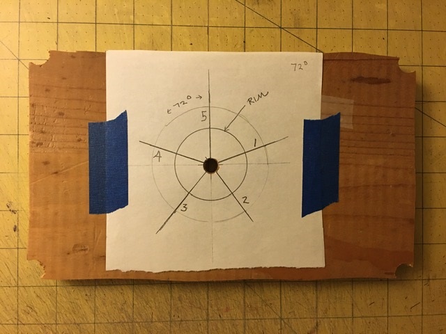

Here are pictures of the wheel parts, wheel jig and a wheel being assembled in the jig...Gorilla(R) super glue used for assembly...trim spokes flush with outside of rim when glue has dried...trim hub to length length and drill small hole for nail axle...
In addition to the five holes drilled through the edge of the rim, five shallow holes, about 1/8" or less, are also drilled in the 3/8" diameter hub...

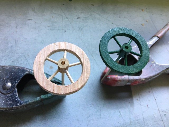

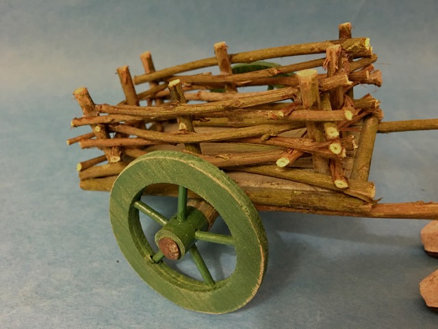

Here are the last closeup photos of the the primitive sheep and cart construction...so I guess you could say this project is finished...
It's been a pleasant change from cardboard for a while...but a few new cardboard projects are in the works...stay tuned...
File comment: Raw wood wheel and spray painted wheel. Edges of wheel will be lightly sanded in a few places to "age" the look of the wheel and simulate wear.
File comment: Bottom view of cart.
File comment: Post and wattle weave sides. Edges of wheel lightly sanded in a few places to "age" the look of the wheel and simulate wear.
