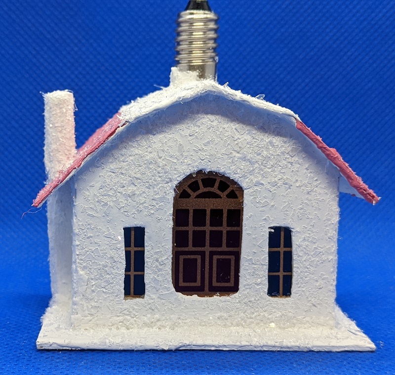

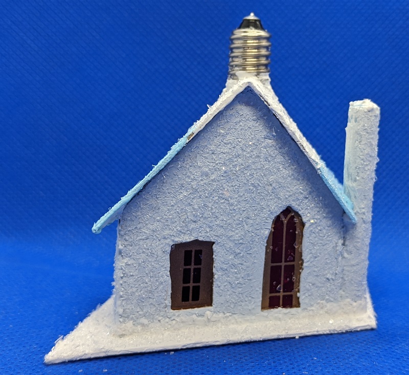

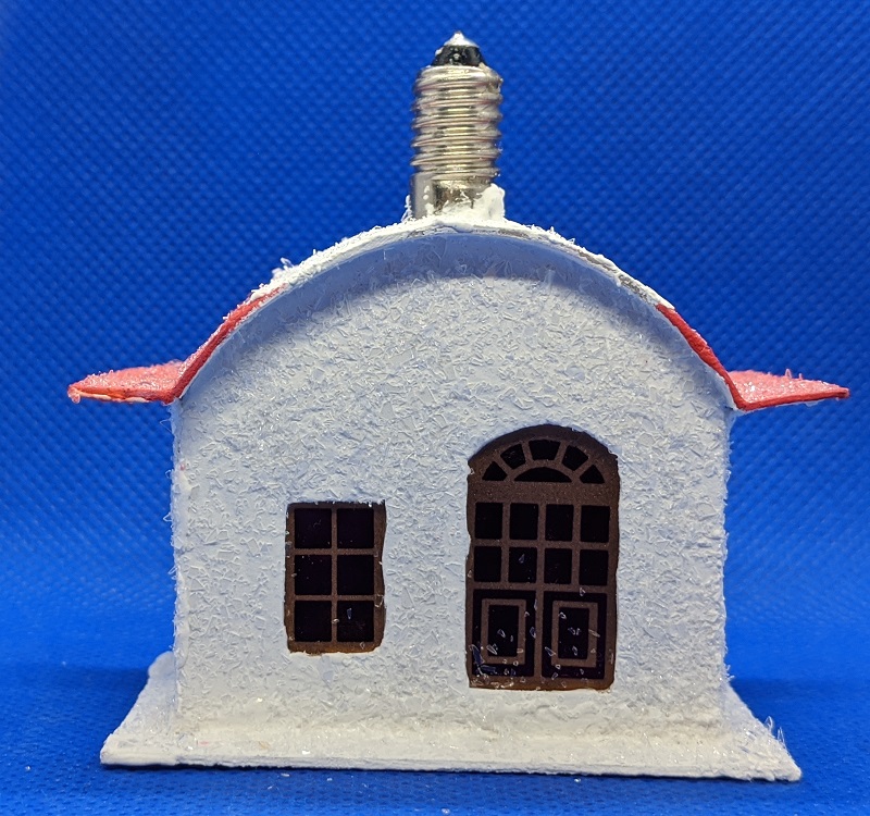

Re: A new project
I got 2 more houses built. I need to make the last two.
house 9.jpg (259.06 KiB) Viewed 20761 times
house 5.jpg (220.48 KiB) Viewed 20761 times
The last two, I don't have a pattern for yet.
I need to sit down and lay them up.

So, here's the last two houses.
house 7.jpg (258.59 KiB) Viewed 20654 times
house 8.jpg (280.57 KiB) Viewed 20654 times
And here is all 8 hanging off of their light string.
All with my custom led bulbs that screw into the custom light string.
Also are a few more of my light-up decorations.
And lastly, I made some LEDs I can put in my Dolly repros.
I wish they showed up better when they photographed.
all 8.jpg (198.35 KiB) Viewed 20654 times
Now what to make next?
