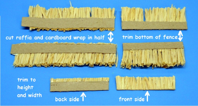

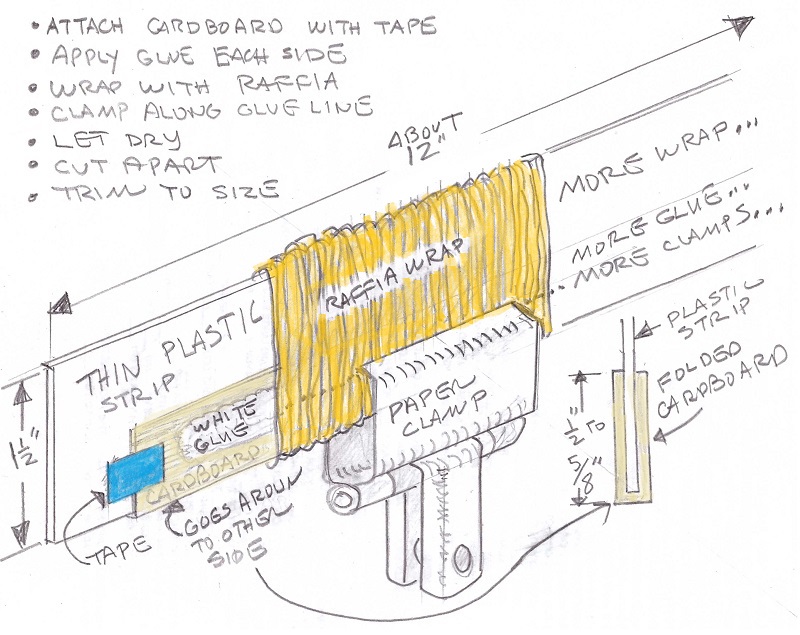

good morning...
here's how i make raffia fence...i know there are other ways...i can explain it but the picture and drawing spell it out much better...
note...the reason i used a strip of plastic is that the white glue will not stick to it...
- raffia fence jig.jpeg (163.81 KiB) Viewed 19080 times
- raffia fence 002.JPG (127.98 KiB) Viewed 19080 times
Re: Pattern for house based on april 2009 house of the month
Awesome! Thanks for sharing, this great!! I really like the plastic and glue idea. Im going to try that next time for sure. It saves a whole step of having to go back and trim the cardboard inside.
