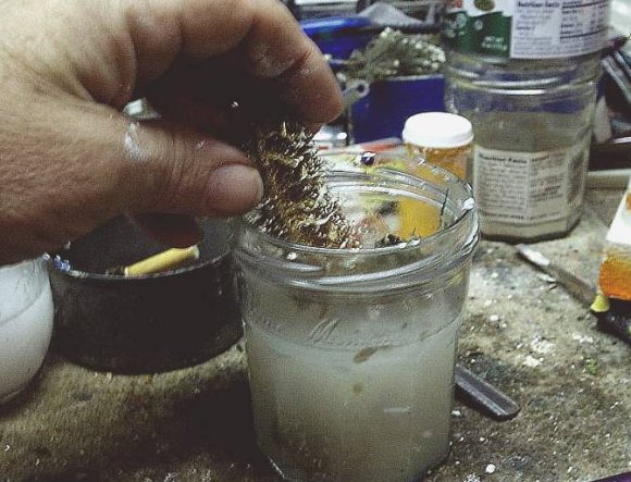

After drying I usually re-glue the trees and then brush on some white latex paint that I have tinted with a touch of black to knock down the over brightness of the paint. Notice that the tree on the left is standing straight now. All that is left to do with this house isto install a some of Papa Ted's Windows and this will be ready for another 75 years.

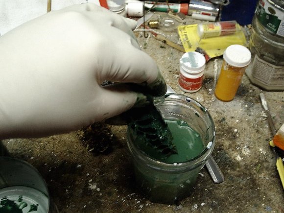

Actually, not all that you see in the upper picture is really useable for trees. The outer "rind" is very dense and doesn't look right. I get my best tree material from the "heart" and the radials coming out from it. Getting the most out of a given luffa is an art you develope like carving a turkey. The pieces above were made by gluing radials back-to-back. The two piece 2nd and 3rd from the right are radial strips before gluing. You then cut a size and shape to be the tree you want and paint as per Tom's description above or do as I do and just immerse them in the paint jar, soak for an hour or so, them bring them up to drip-dry on toothpicks.
