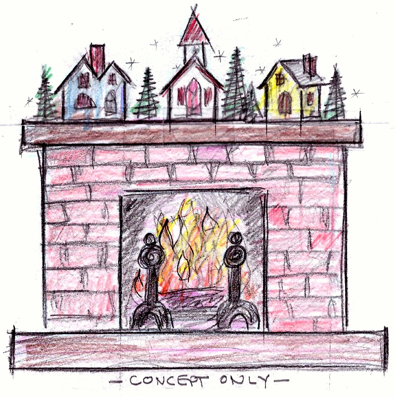

It’s a new month…and what better way to start than with a new project…an illuminated miniature fireplace and a series of interchangeable houses…
Lynn will be designing and posting patterns for the houses…each sits on a 2” x 2” square base with a strategically placed light hole that aligns with holes in the top of the mantel…I’ll concentrate on the fireplace and the simple illumination system…

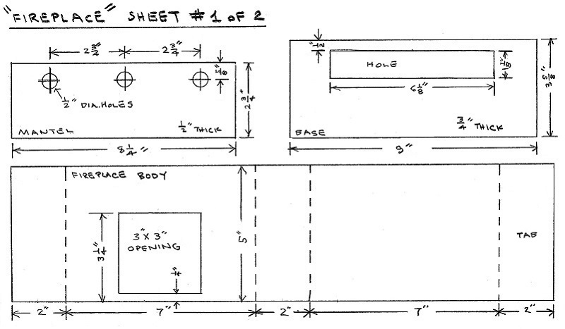

FIREPLACE PARTS…

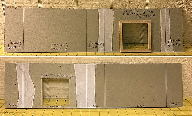

Main body…folded cardboard…3” x 3” opening…¼” x ¼” wood strips…ignore gray reinforcing paper strips…
Base…laminated corrugated cardboard…¾” thick …¼” x ¼” wood strips…6 1/8” x 1 1/8” hole for light box…

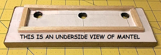

Mantel…laminated corrugated cardboard…½” thick…three ½” diameter light holes…¼” x ¼” wood strips…

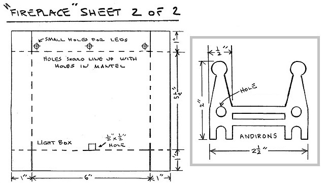

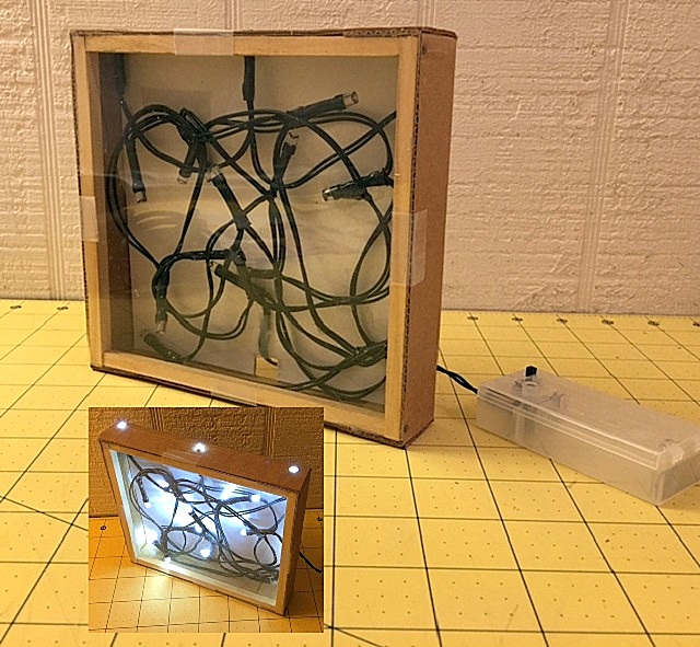

Light box…folded cardboard…6” x 5 ½” x 1”…¼” x ¼” wood strips…white poster board reflector on inside…clear acetate cover held on with tape…
LED lights…string of 20…AA battery powered…mine were from Wal-Mart…similar items are available at other stores and on-line…

Andirons…cardboard…toothpick mounting pins on backside that glue into small holes in base…

After covering with printed brick and wood graphics, the base, body and mantle are glued together to make one piece…
The flame graphic is glued to the inside of the 3” x 3” fireplace opening…
LIGHT BOX NOTES…
Three LEDs are glued in the small holes in the top edge of the light box…this directs the light through the holes in the mantel and into the holes in the base of each house…the remaining LEDs are randomly arranged in the light box…
I did add a double layer of yellow tissue paper between the LEDs and the clear acetate cover to “warm up” the color of the “bluish white light” emitted by the LEDs…
“Orange“, “red”, “yellow” or “warm white” LEDs might work better and make the fireplace flames “glow” even more…a “flickering” LED light setup might really bring the flames to life…I may look into that at a later time…
The light box slips in the opening in the fireplace base…it is not glued in…the battery box wire is fed thru the hole in the back of the light box and sits in a shallow relief slot in the bottom of the fireplace base…
miniature concept only.jpg (308.29 KiB) Viewed 47124 times

This sounds like a lot of fun, much like the witch's lair and the Dollys and the pack o'fun houses. I'm in. I really like seeing your concept sketch too.

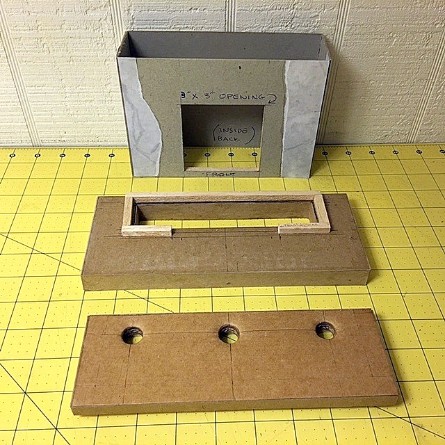

here are some additional photos of the fireplace parts and how it all goes together...
i'll post pictures of the light box and other details later...

I LOVE the concept drawing!! It's so fun to see inspiration before finished product. :) Super awesome project!! Cant imagine making micro putz houses to fit on the mantel.

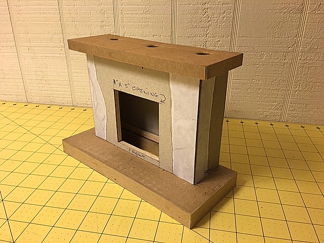

thought i'd go ahead and post two more progress photos of the fireplace and the completed light box...
the three major fireplace parts are shown assembled just for the photo...i still have to cover them with brick and wood printed graphics...then i'll glue the base, body and mantel together and glue the flame graphic in the opening...
the light box photo does not show is the layer of yellow tissue paper under the acetate cover to warm up the bluish light emitted by the cool white LEDs...

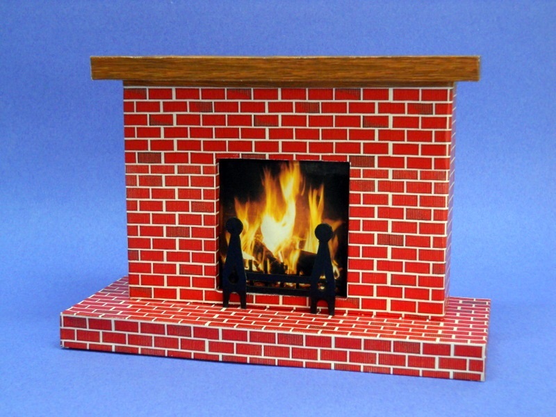

my fireplace is now finished...all the graphics have been applied and the andirons put in place...the light box is also finished and working...
i know Lynn is very busy with the little houses...i've had an "advanced look" at them...you will find it hard to believe they are miniatures...trust me...
you'll also really like a few other personal touches she had added to her version of the fireplace...

Great fireplace!! Can't wait to see the mini houses. You are a master at applying those graphics...No easy chore in my book!

WoW - That fireplace looks real! I can almost hear the wood crackling! What a nice project. Going to add this to the 'to do' list. Which now is about a mile long LoL! Thx for sharing Howard
