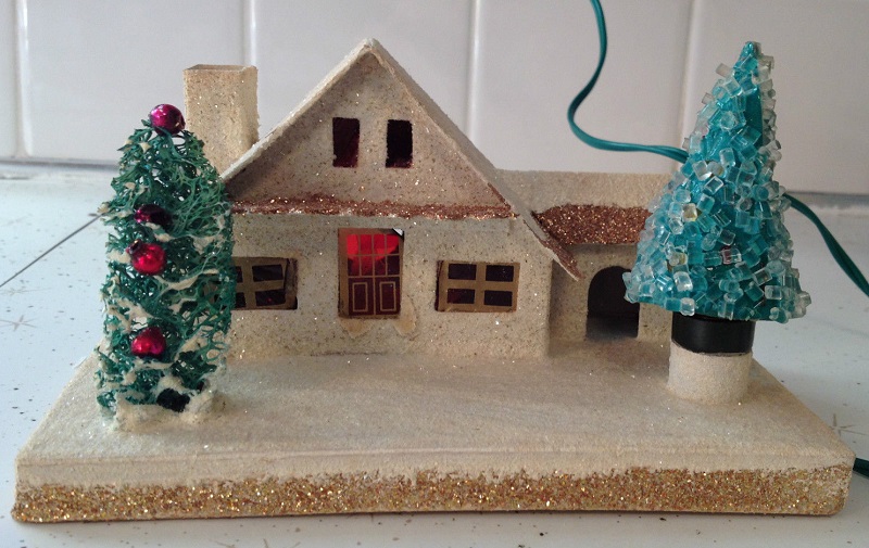

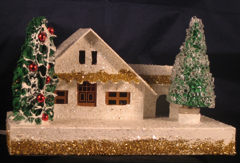

So I saw an Ebay auction of a house I've never seen.
It appears to be made in the 1950's.
The thing that caught my eye was a light up tree.
Seems the tree sat on top of a C7 christmas light bulb.
It had holes drilled in it then the hole were covered with colored cellophane.
when light up it lite up w/ multi colors.
The auction house is the first shown.
my house unlite and lite are below it.
twinkle 800.jpg (155.79 KiB) Viewed 21122 times
My house unlite:
twinkle house 800.jpg (195.6 KiB) Viewed 21122 times

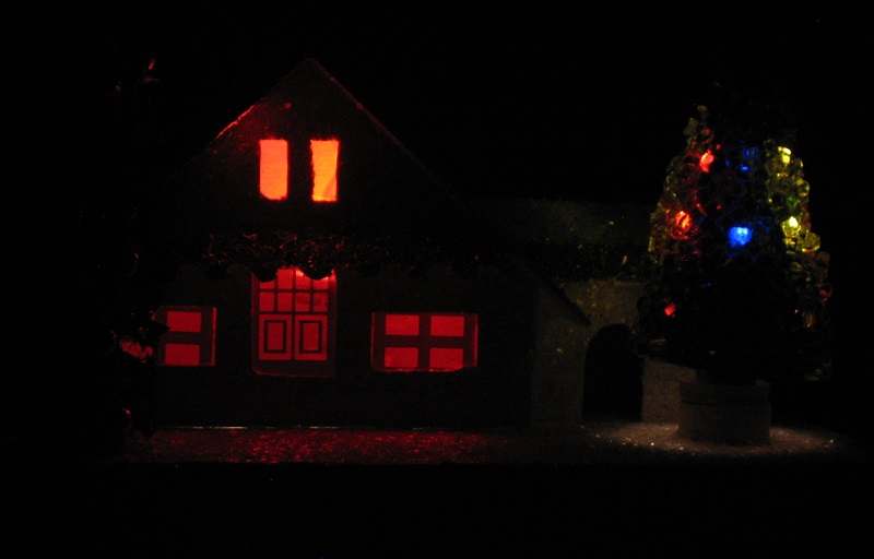

House lite up:
twinkle house light 800.jpg (69.95 KiB) Viewed 21122 times

an "excellent reproduction"...
could you give us a few details on how you put together the illuminated tree?...
Posts: 1127
Re: Newest house
Steve, great job looks just like the originsl. I would also love to hear how you made this tree.

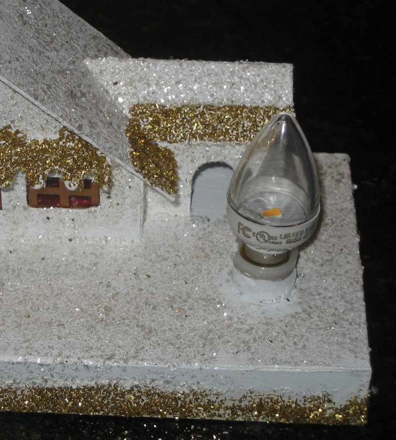

So how I duplicated the tree.
First the house base has a C7 socket base embedded into the house base.
No worry about fire. I used a LED C7 bulb. Produces no heat.
twinkle c7 base.jpg (261.32 KiB) Viewed 21086 times

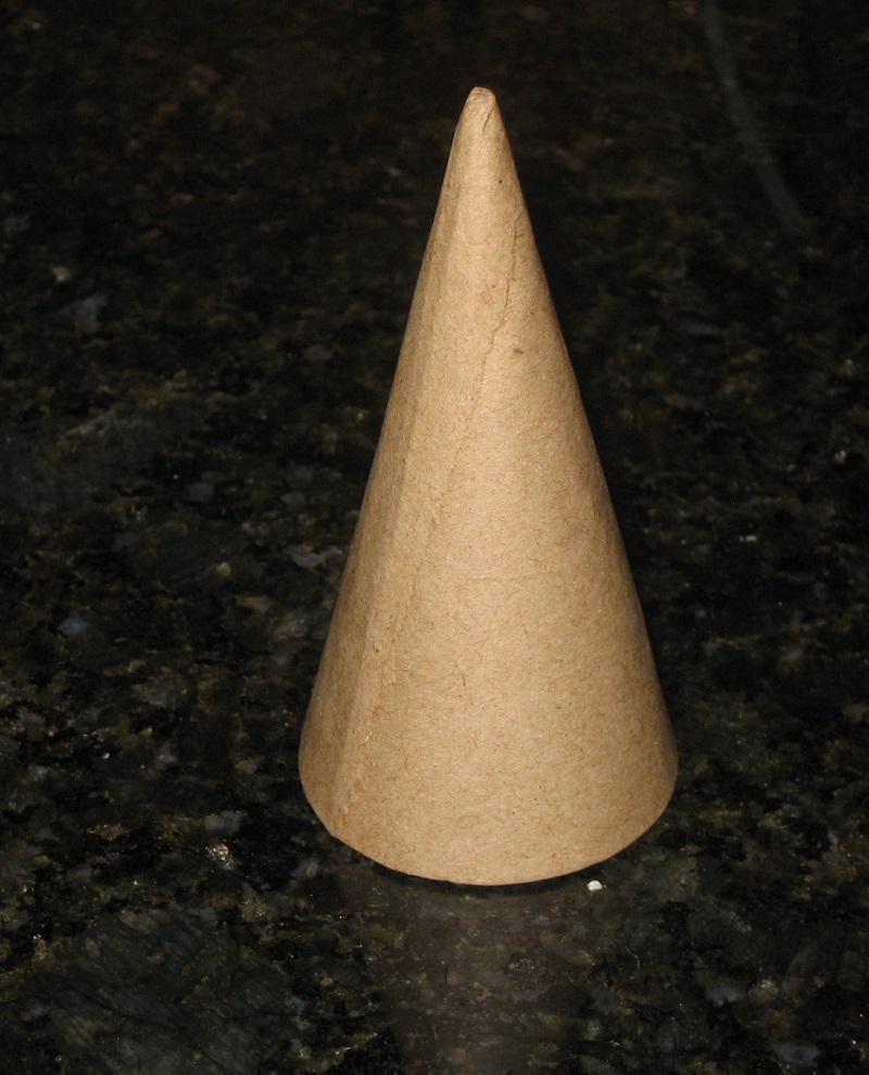

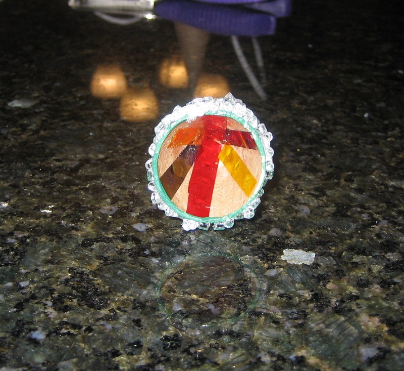

For the tree you start with a paper cone.
Mine were store bought. but you could make your own.
It is then cut to size. And painted green.

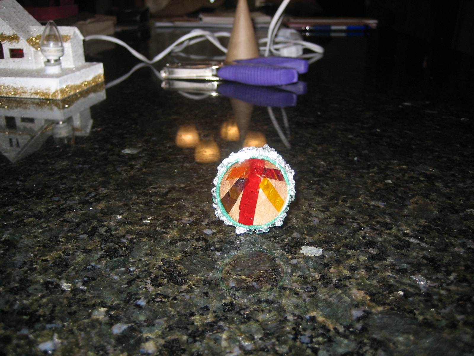

After painted, I punched 6 rows of holes with a deep throated 1/8" punch.
you then add 6 strips of cello on the inside.
tree inside.jpg (231.42 KiB) Viewed 21086 times

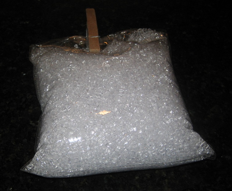

Now you add some really big glitter. Mine is arrangement plastic stones used for floral arrangements.
big glitter.jpg (163.76 KiB) Viewed 21086 times
I need to spray with a clear coat after, as the big glitter tended to fall off.
Place it on top of the LED c7 bulb and your done.
Re: Newest house
AWESOME Job Steve!! The tree is amazing, I would never have know yours is a repro other than how new it looks!! So great!
