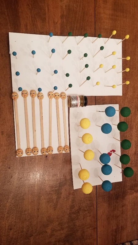

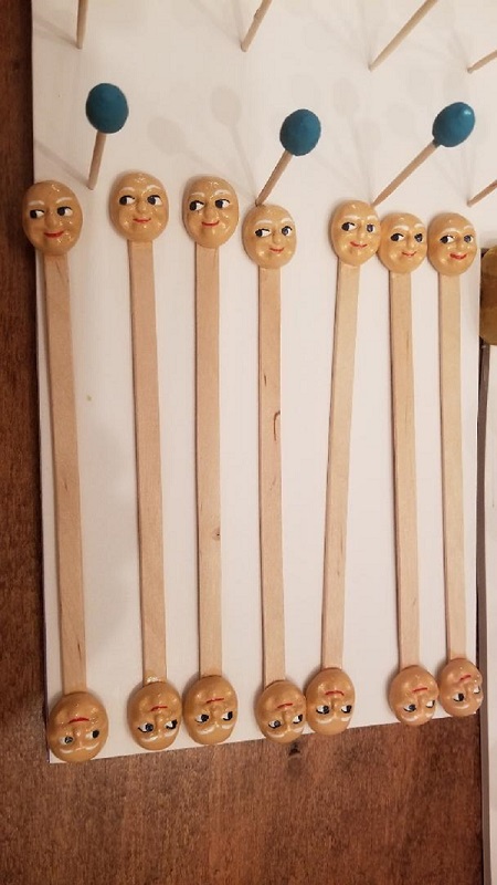

Hi everyone, I've been bit by the elf bug.
These elves bring back wonderful memories of my Mon, a collector of elves. I am making up a bunch for gifts, so I went with the ensemble system for painting everything.
Thanks to a forum friend I have some faces to make my elves. First I painted the spun cotton bodies and feet, and than the faces finishing with 2 coats a high gloss finish.
- faces painted.jpg (98.46 KiB) Viewed 32692 times
- Painting body and feet.jpg (124.77 KiB) Viewed 32692 times
