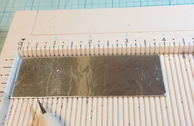

1. Cover the cardboard with foil tape. You can get this tape easily at a hardware store or one of the home improvement stores. It is not the flexible duck tape, it is true foil-covered "duct" tape to help seal ducts. I found it in the tape section at Lowes I think.
2. Then score the taped cardboard to look like the ridges on a sheet metal roof.

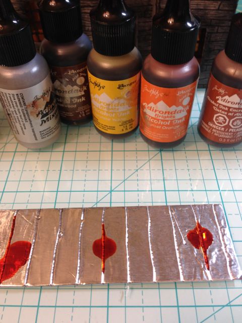

Now you have the scored cardboard with the alcohol inks lined up behind them.
Drop some of the alcohol ink on the foil-covered cardboard and smear around.
5 Alcohol inks for rusted roof cc.jpg (70.96 KiB) Viewed 28039 times
6 Drop alcohol inks on foil cc.jpg (61.16 KiB) Viewed 28039 times
7 smear with finger cc.jpg (49.76 KiB) Viewed 28039 times

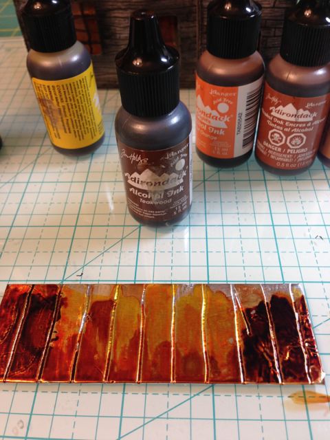

Re: Rusted Tin Roof tutorial
Continue to smear the ink around with your finger. I used progressively darker inks as I went along. I really think 3 colors is probably sufficient - a gold, orange, and brown.
8 smear 1st layer of ink cc.jpg (61.17 KiB) Viewed 28039 times
9 add diff alcohol ink colors cc.jpg (63.69 KiB) Viewed 28039 times
10 add progressively darker inks cc.jpg (64.86 KiB) Viewed 28039 times

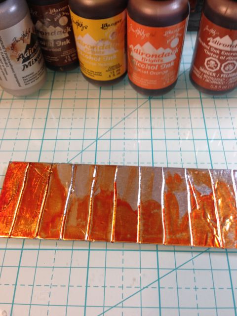

I added something called "Silver mixative" which seemed to make everything meld together nicely, but truly I don't know what it is supposed to be used for.
Smear everything together again.
Then I used some acrylic distress paint (probably any acrylic paint would do) and painted the edges darker to complete the aged look.
And that's it. It's a really easy roof to do. Much easier than cutting shingles like I did for some of my other houses.
