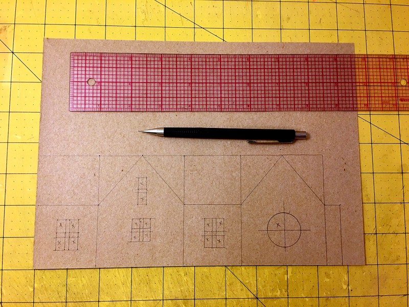

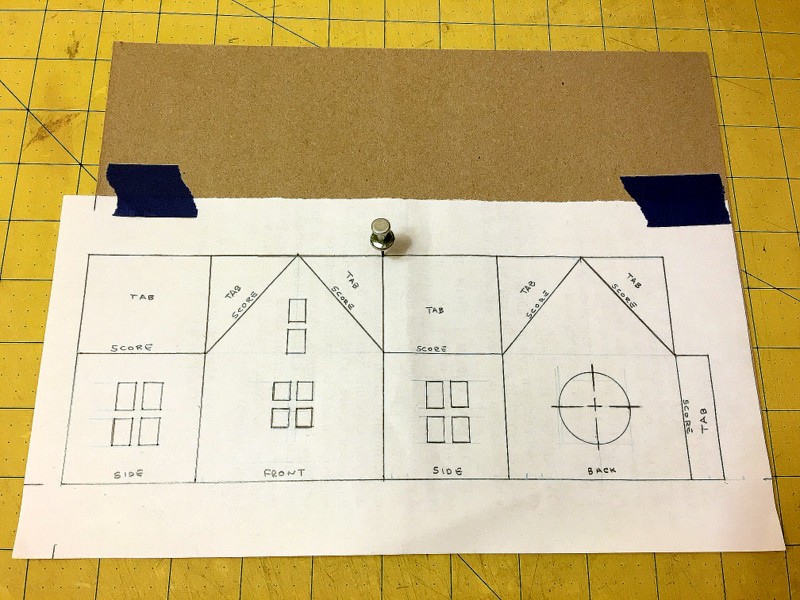

in a recent reply to a post by new forum member, steve, i said i'd post my method of transferring patterns to cardboard...
it's quick and simple...hasn't failed me yet...
1. tape pattern to cardboard...
2. punch a hole thru the pattern into the cardboard at important line intersections...
3. connect the pin holes in the cardboard with a sharp pencil and a ruler...
it works for me...
tape pattern to cardboard and  transfer important line intesections with push pin.jpg
tape pattern to cardboard and transfer important line intesections with push pin.jpg (138.5 KiB) Viewed 17747 times
connect the pin holes with shapr pencil and ruler-001.jpg (180.91 KiB) Viewed 17747 times

Wow Howard, "simple" is always the BEST! Thanks so much for sharing! :)

Thank you for sharing that.

Oh! That makes it really easy!! Can't wait to try it on my next building.
